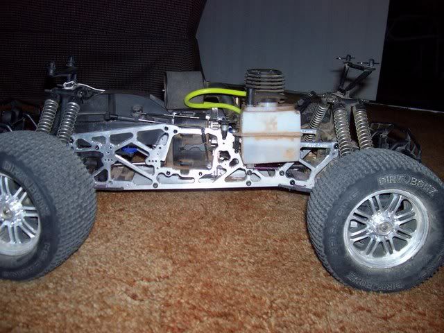

That's a clever idea for a fuel tank mount, are you not worried about flooding the engine? The tank is higher than the carb now.
